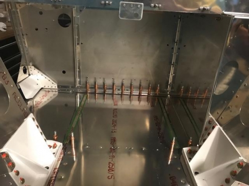

Rivet attachment of the 14 nutplates to forward baggage floor pieces
Back rivet stiffiners to the baggage floor
Match drill the lower angle of the firewall to the floor. Debur and dimple/countersink for sealing up the floor from firewall. Epoxy the 9 holes between the engine compartment and the forward floor. Rivet the angle to the floor assembly (except for the center 9 holes, which were epoxyed) I've been keeping the Proseal/fuel tank sealant in the fridge to help preserve it, which has worked well.
inside the gear box assemblies showing the epoxy section on the firewall
