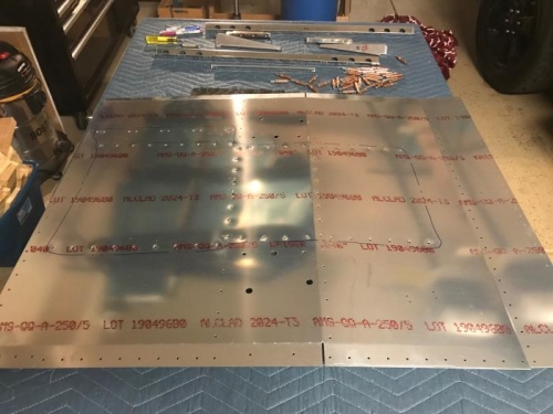

Dimple / Deburing floor assembly
Dimpled the floor assembly. it was difficult to dimple due to the thickness. I had to punch it three times to get the appropriate depth/dimpled.
Debured the floor assembly including the crossmembers/ribs. Dimpled the matching #30 holes in the ribs/crossmembers.
Top of Floor assembly
