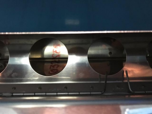

Pulled off the hinge assemble from the Right flap and clecoed into place the hinge. Squeeze riveted on the hinge assemble and then mount on the flap, sliding in the two hinge pins.

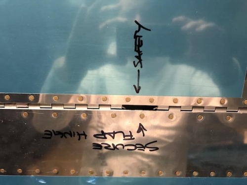

I selected to go with the two hinge pin method. (This may prove to be a mistake? I thought it would be best if I could removed the flpa without removing the Aileron. The challenge is I still need to safety secure the two hinge pins with safety wire and possible drilling a hole intot he skin or flap fairing? Something I will need to figure out, for both flaps)
Center hinge pin assembly
Hinge pin connection for flaps
