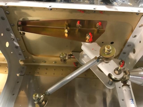

Brief Description:  Mounted the Garmin 28 servo bracket as part of th
Mounted the Garmin 28 Roll servo bracket. Replaced the bottom bracket piece for the servo mounting kit (Kit was purchased from Aircraft Spruce, Garmin bracket assembly 75.00) Not muck of a bracket and could easily be made from scratch if you had the servo at the time of assemblying the wing. (since I planed to buy the auto pilot servo during final assembly I simply mounted the bracket into pace)
Torqued all pushrod hardware to specifications and applied torque seal paint for easier inspection.
Bellcrank assembly with Roll servo bracket in place

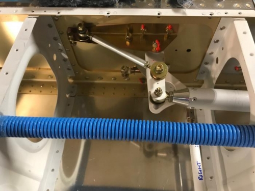

better view with the autopilot pushrod pulled back.  I pushed hardware inplace for final servo mount'g
