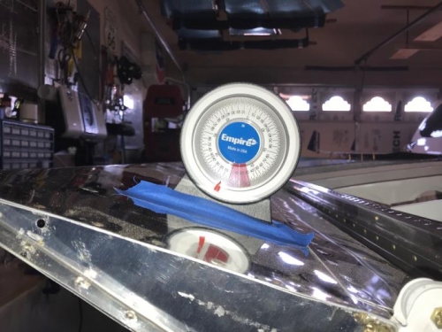

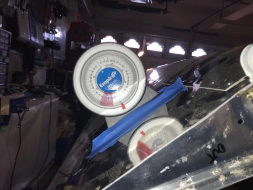

Manual Reference:  Aileron assembly
Brief Description:  Removed the push rods andcut out some of the ar
Measured the range of motion for the Aileron up and down. While the range was still within the listed range, the smaller push rod was rubing against the opening in the rear spar. Removed the push rod and cut away more for the opening. Measured final range of motion for the left Aileron.
Wing is upside down on it's top skin
Neutral postion -10
The Down angle is positive 15, so adding the 10 degrees from neutral position for a total range upto 25 degrees (chp 15 MFG required range 25/15)
The Up angle is negative -44, so subtracting the 10 degrees for a total range upto 35 degrees (MFG required range 32/17)
Neutral postion measured at -10 degrees
