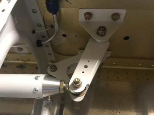

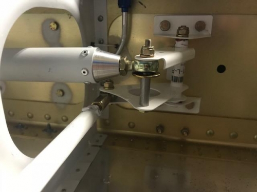

Manual Reference:  Aileron assembly
Brief Description:  Assembly of the bell crank and push rods for the l
Bolting on the bell crank assembly. I had to ream out the connecting rod for the brass bushing. Greesed it up manufactured the required spacer and tourqed the bolts to specification
Left wing push rods and bell crank assembly
