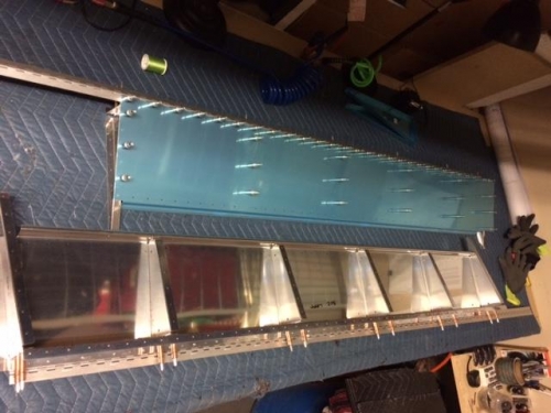

Clecoed the structure assembly, ribs to the flap spars for both left and right flaps. Match drilled the ribs to spar, expanding the holes to #30 for what looks to be blind rivets.
Clecoed the bottom skin the each fo the flap assemblies. Match drilled skin to the ribs and spar. Squeezed in the mounting hinge and match drilled both the left and right flaps.
Bottom skin of both flaps
Top of left flap and bottom skin for right
