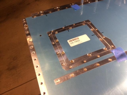

Flared the pitot tube lines with bushing/fittings for assembly. Verified fit inside the main spar assembly.
Using the phenmatic squeezer I flush riveted the first two rivets on each rib of the leading edge. I used bundges and wedges in the leading edge cradle to fit skin to rib while squeezing the rivets. Then began the flush riveting using the bucking bar and rivet gun
I also rewored the bottom access panel since it didn't fit as nice as I would like. I use a larger dimple and tightened the gapping to really squeeze the metal sheeting (turned out much better than previously
flush rivets on bottom of leading edge assembly
Bottom access panel
Bottom access panel
