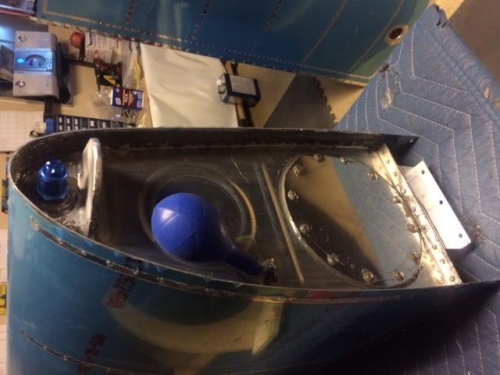

Repair leak in Left tank from failed tank test
I cut away some of the sealant by the leading edge mounting angle and used a surenge to compact sealant between skin and mounting angle.
Leak detected by mounting bracket on left tank
Baloon test for tanks
