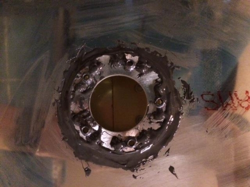

After cutting out the doubler rings, I used sealant to attach them to the baffle backing plate. Countersinking the skin and riveting on the nutplates for the attachement of the fuel sending units.

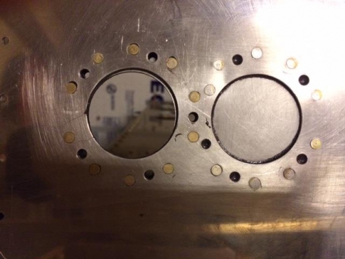

I did have a mistake that I had to improvise for. Since I did not mount the sending units into the end rib (since I went with flop tubes on both ribs) I had still ordered a left / right sending unit and didn't think about the difference in nutplate possition until after I had cut the access hole and associated nutplate holes. This required a back plannel sealed and riveted into place to close up the holes. Photo shown below
Inside tank position of the doubler plate sealed into place with nutplates
Mistake due to left/right fuel sending units
