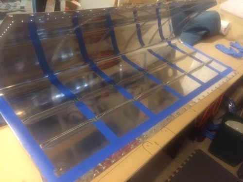

Final preparation for sealant. D/A surface areas on skins and stiffners. I taped over the rib areas to prevent sealant adhering to future areas.

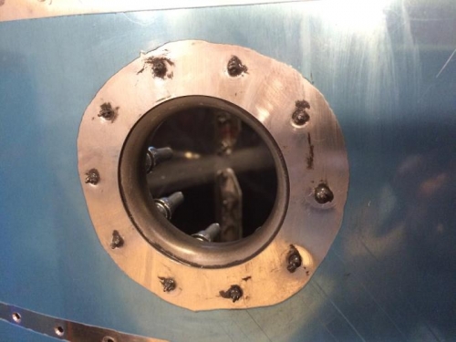

My second batch of sealant I mixed 100kg and it was enough to set the second set of stiffiners as well as the filler necks and two drain points. I was much more relaxed the second mixing. I set the filler necks with clecos in each hole for the filler necks and each of the holes for the drain valves. Once the clecos were set I could form the fillets for the filler necks and drains. I came back and flush riveted the connections with a bucking bar. Once the filler necks were cleaned up I sealed each of the shop heads for the filler necks and drain valves.

Preped D/A and cleaned wing skins

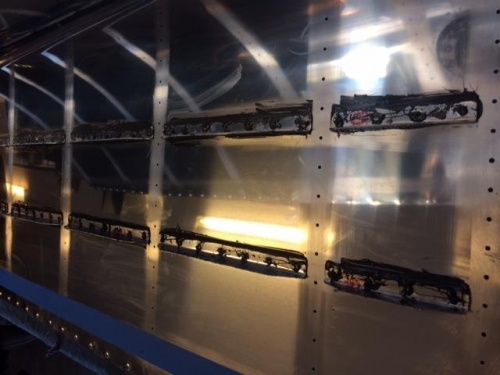

stiffiners sealed and riveted into place
Filler neck cleacoed into place
