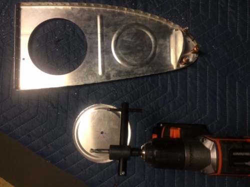

Brief Description:  Drilled the access hole in the rib with a Fly-cutt
Yes, I drilled the hole with a Fly-cutter on a cordless drill. (I watched a you-tube video of a successfull hole with a hand drill and thought I would give it a try before I took it to work to drill complete with a drill press.
I ordered the access plate with out the fuel sender hole. I also ordered the Pro-Seal for final tank assembly. Still some work to compelete, but they listed a 4 month shelf life on this new Pro-Seal at Vans. I still need to mount the fuel sending devise through the back baffle.
test hole with Fly-cutter
