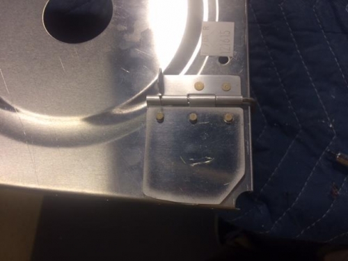

I debured the tank ribs for both the left and right tanks. Additionally, built the hing flap system for inverted fuel/flight. The fabricated hing system took a couple tries. The problem was the hing assembly and the direction of the door stop.
Looking forward to trying out this product inflight. It's really a great design to retain fuel in the tank area closes to the wing root / imbound assembly.
Open hinged system
Open hinged system
