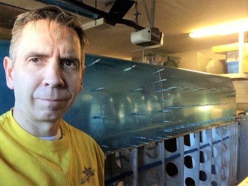

Stiffiners clecoed into place on bottom side of tank skins

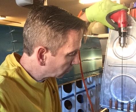

Match drilling rib to baffle and brackets

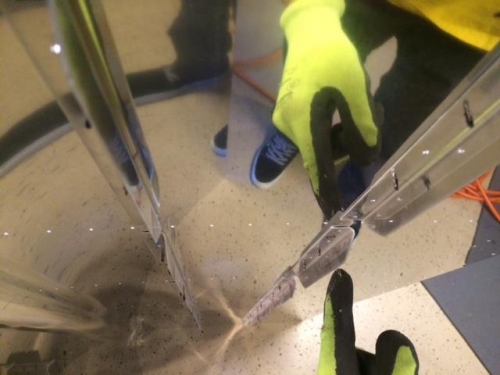

Tank skin attached for fitting
