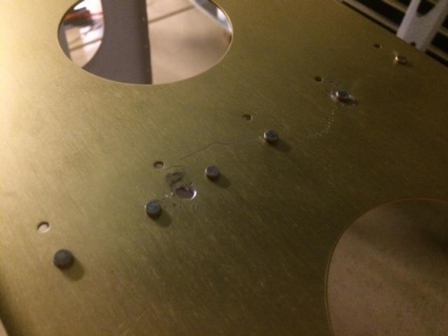

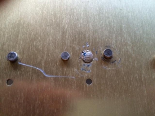

I had a rivet on the main spar that I couldn't remove clean. (The obvious concern is rivet quality vs the damage during removal for re-riveting) In this case I drilled two new rivets, one on each side of the damage area.
I used a counter sunk rivet to fill the hole (Rough night, very frustrating)
re-riveting mistake
re-riveting mistake
Counter sunk rivet to fill hole
