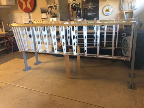

Re-reivet doubler plate on rear spar assembly. I had to drill out a number of rivets that were not acceptable
Cleco the rear spar assembly to the ribs and main spar assembly. I attached a thin twin to measure the center support needed . Final cut and trimmed a couple times for fit.
Fabricate the cradle for tank assembly
Wing stands with ribs
Main and rear spar assemblies attached to wing stands
