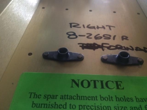

My wing stands are just a little to close together, I had to remove the spars and rivet the two nut plates on each main spar and re-attach spars to wing stands.
I made a stencil to prime the counter sunk attachment points at the nutplate locations on the main spar.

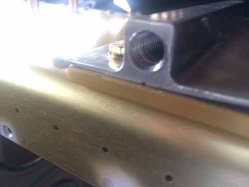

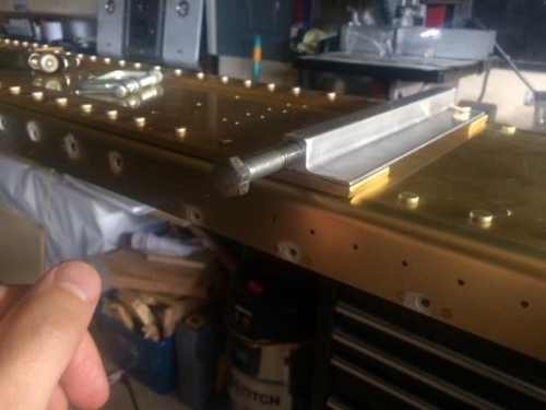

I began the tie down assembly, drilling the upper right hold and marking out the spacers. I tapped the aluminum for the 3/8" 16 thread eyebolts which will thread into the assembly.

Tapped aluminum for theaded eyebolts
forward nutplates on the face of the spar
