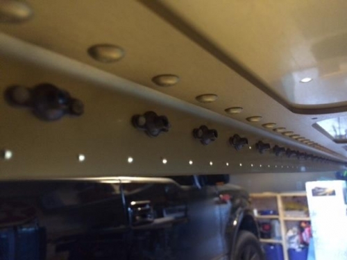

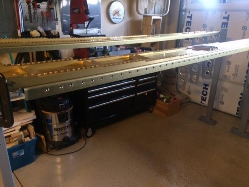

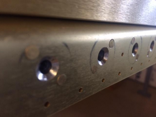

Counter sunk screw heads for nut plates on right main spar, bottom section. Debur and countersunk rivets for the 30 nutplates on the bottom of the main spar. Flush riveted the 30 nutplates to main spar assembly
countersunk screw heads and flush riveted attachment
Back side of main spar where nutplates are attached
Right main spar
