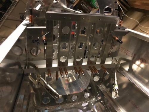

Brief Description:  Final fabrication of ski rack brackets
After making a cheap mock up to determine if I could even fit skis in the rear baggage/fuselage section, I began work on the final brackets that will hold the skis.
Sheared off some aluminum and broke the pieces into 3/4" angles pieces. I also used the sluminum u-shape pieces I had to cofirm that it would hold skis. Cust sections into final length. Drilled rivet holes in all pieces and debured all pieces.
Drilled lightning holes as many as possible.
Designed it to hold two pair of skis. Need to tr it out
Rear ski rack bracket
