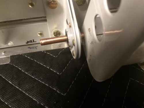

I wanted to check the 1/4" copper tubing to see if it was going to work as a drill guide. I had to buff it down a little to fit, but provided a tight fit and worked great. I drilled the left elevator horn for connection.
Bearing with copper tubing for drill guide
