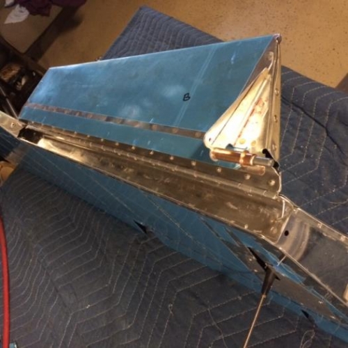

Final elevator assembly
Assembly of the electronic trim system. Match drill and rivet trim tab. (I had to be creative and attach a small piece of wood to my bucking bar to reach the final trim tab skin to the trim spar.) Blind rivets used on the end pieces of the trim tab skin.
Final dimpling, edge preparation, and rivet the skin to the skeleton structure.
Attach the hing system to for trim tab. Flush rivet skin for tab and elevator assembly. (I still have the addjustments for the trim arm.
Trim Tab
Trim Tab
Left elevator full assembly
