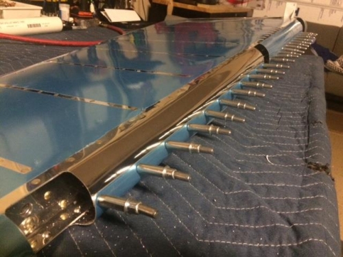

Brief Description:  Bending/forming leading edge of Rudder
I tried to devlop a tool with two rollers and use a piece of 1 1/2" PVC to roll the leading edge. I could not apply enough preasure to make the tool work. In the end I did just as the Van's construction manual suggest and used a 3/4" PVC piece and hand rolled/formed the the leading edge.
Clecoed and match drilled the pieces together
