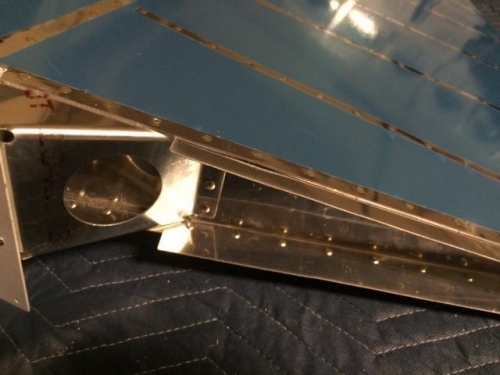

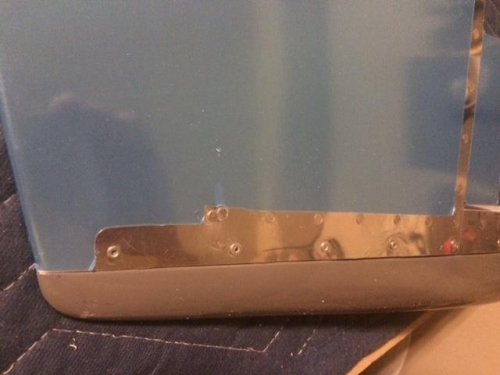

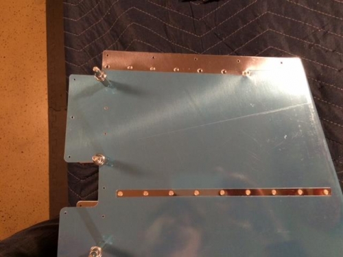

Flush rivet rudder skin to the upper and lower ribs and the spar assembly. Double rivet on upper edge (dimplling mistake which caused an additional hole in the rudder skin. See photo)
All rivet and dimpling work looks good. I did use blind rivets for the two trailing edge bottom holes.
Double rivet from dimpling
