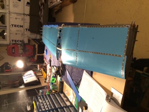

Brief Description:  Rivet the right side skin to the forward spar and

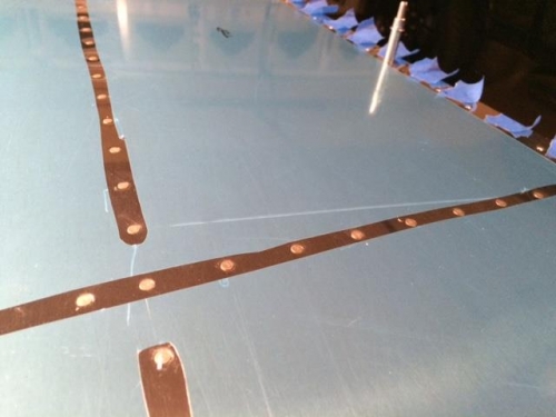

Riveted the right side skin to the forward spar and center 707 and 708 rib. Both top and bottom. After struggling with the shape of the left skin to the center rib I tried riveting the forward rib, top skin, without clecoing the skin along the rib section. MUCH EASIER. still required an extra hand, but the lose skin was much easier to rivet the forward connections working forward to aft. one rivet at a time shaping the skin to the rib. The bottom required a second hand to apply pressure.
Rivets allong the top center rib
Horz. stabilizer with skin riveted to center ribs and forward spar.
