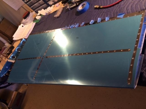

Riveted the front spar and center rib of the left side of the horizontal stabilizer. Flush rivets top and bottom. Difficulties with 707 center rib. The shape of the skin to the rib made it difficult to rivet the forward rivets. I had Kasey (daughter) help rivet as I applied preasure to keep the skin close to the center rib.
(On the Right side I will try to rivet the forward rivets without clecoing the other sections allowing the skin to relax at the forward couple rivet sections)
Left side of horz. stabilizer
