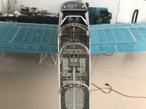

Worked on the right and left flap assembly. Enlarged push rod accesspoint to accomodate the push rod movement with flaps are cycled.
Re-wrapped the push rods since the access opening edges had scraped the push rods.
Flap assembly mounted for both left and right flaps
Adjusted the left flap trailing edge to match aleron trailing edge
