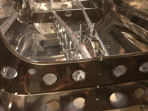

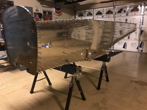

Rivet the 808 bulkhead to rear bagage ribs. slide mid longerons into place on rear 811 bulkhead. Assemble / cleco the rear bulkheads w/ longeron into place as well as the other bulkheads.
Cleco the bottom skin into place
fuselage
bulkhead riveted to bagage ribs
