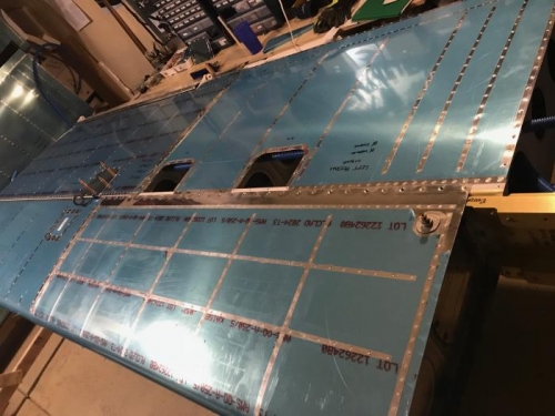

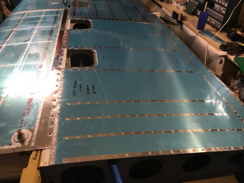

Brief Description:  Finished riveting the bottom skin for the left win
I finished up riveting the bottom skin for the left wing. Riveting progressed faster as I neared the end of the wing where all ribs faced outbound direction and I didn't have to reach through the lightning holes and back to the acute angle for inbound facing ribs.
Cut the piano line for the flap hinge assembly. fixed the flap to the wing and taped the flap secure for storage.
With the help of my new son-in-law we repositioned the wing into the cradle and pulled out the Right wing for final assembly
riveted skin for left wing
Left wing back in the wing stand
