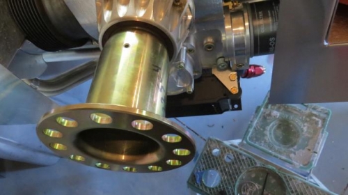

Date:  11-8-2015
Number of Hours:  1.00
Brief Description:  Prop Flange
Installed new prop flange with 4" bolt pattern, Torgued flange bolt to 300nm (225ftlbs) as per maintenance manual. Installed locking collar, drilled 5mm hole through prop flange into locking collar. Tapped to 6mm thread and installed allen screw to lock flange bolt and locking collar in place. As soon as I receive flange lugs I can install prop.
standard 4
standard 4" prop flange
