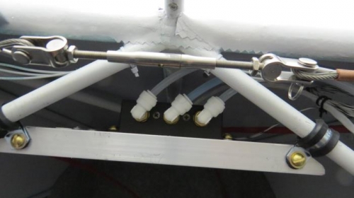

Fabricated brackets and installed the Dynon ADAHRS. Installed OAT probe and connected all wiring and plumbing to the ADAHRS. Leveled the mounting platform to all 3 axis. Once the airplane is flying shims can be used to make minor adjustments to the mounting to insure that the ADAHRS is parallel to all 3 axis.
