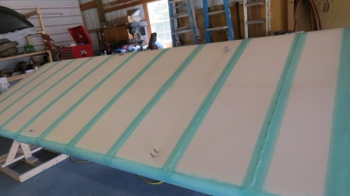

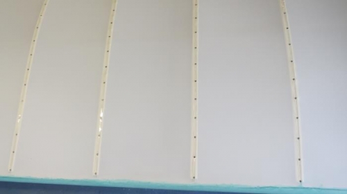

Put final shrink on fabric on left wing. Used soldering iron to melt holes at all rivet locations. Applied double sided tape and cover straps over rivet holes on #3 thru #11 ribs. Riveted cover strips to ribs. Applied 4 inch tape to leading edge and 2 inch tape to trailing edge. Applied 2 inch tapes over all ribs on bottom of wing.
Riveted cap strips to ribs
Tapes applied to bottom of ribs
