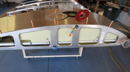

Date:  8-7-2015
Number of Hours:  7.00
Brief Description:  Left Fuel tank
Finished installing left fuel tank. Installed fuel lines to sight guage and main fuel line to wing root. DImpled all #30 holes in root rib and #2 rib. Dimpled all holes in lower root skin. Dimpled all holes in upper root skin. Dimpled all holes in root skin stiffeners. Clecoed stiffeners to root skins. Removed one cleo atg a time ad flush riveted stiffeners to root skins. Checked all wiring, pitot/AOA tubing and fuel lines for security. Clecoed lower wing skin in place. Flush riveted lower root skin in place.
Applied gas proof adhesive to capture ring and fuel scupper. Transferred drilled capture ring to Fuel cap assembly to #11. Modified cover ring as per plans. Will allow adhesive to dry over night.
Left fuel tank
Left fuel tank
Left fuel tank
