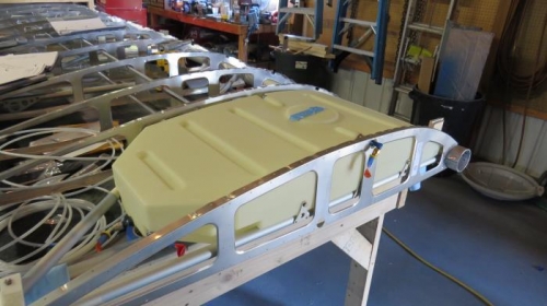

Inspected extruded aluminum tubing for cracks and dents. None found. Assembled lift struts in accordance with manual. Upon completion, wrapped struts with packing paper and put back on stroage racks. Struts will be painted later.
Installed remaining fuel fittings in fuel tank, leak checked. No leaks. Mounted fuel tank in left wing. riveted #2 and root ribs in place.
Installed Pitot/AOA tube through forward spar, Fabricated a bracket to attach tube to rear of forward spar.
Left Fuel tank
Left Fuel tank
