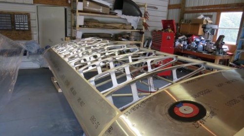

Moved everything out of shop and cleaned floor. Rearranged things to begin covering right wing. Set travel on rudder to 28 degrees, finished trim on door frames.
Performed pre cover inspection of right wing.
Cleaned wing structure with isopropel Alcohol. Appleid anti chaff tape to all sharp edges. Burned holes through tape at rivet holes with soldering iron. Inspected all rivets, bolts and nuts for security. Ready to apply fabric to right wing.
Right wing
Right wing
