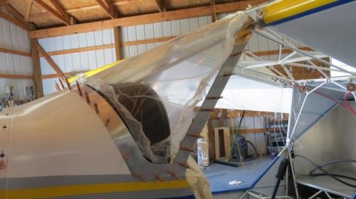

Installed skylight ribs, riveted dash in place, installed dash closeouts. Clamped windshield in place, marked trim lines and trimmed with dremel tool with cutting wheel, then sanded edges smooth. Reinstalled windshield and clecoed all trim strips in place.
Windshield right side
