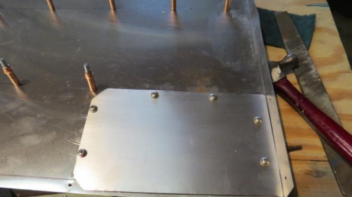

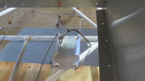

Cut two inspection holes in the baggage compartment. One on the back right side over the ELT. Installed rivnuts and fabricated a cover plate. This provides convienent access to the ELT. Also cut an inspection hole in the back panel of the baggage compartment. Installed rivnuts and fabricated a cover plate. This allows access to the bellcrank assembly mounted just aft of station 4.
Sta 4 bellcrank access panel

ELT Mounting bracket
