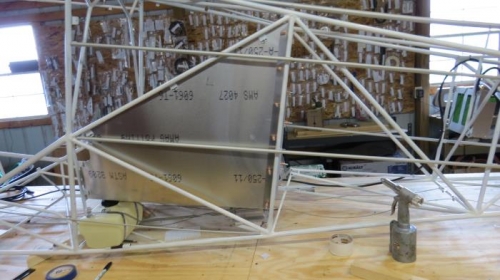

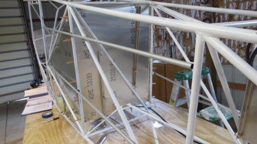

Brief Description:  Fit up Baggage Compartment
Assembled and fit up baggae compartment. Manual recommends installing baggage compartment before cover but not installing the elevator controls. However the new aluminum baggae compartment is so large that installing anything aft of the baggage area would be impossible after cover. I recommend installing all components aft of the baggage compartment before cover.
