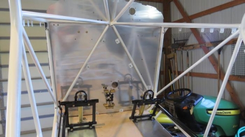

Trial fit firewall and clecoed in place. Mounted parking brake valves and brake fluid reservoir. Reamed mounting tabs for seat belts and installed seat belt mounting bolts prior to cover. Hand tightened bolts. Installed ELT mounting bracket on provided tabs.

Parking brake valves
