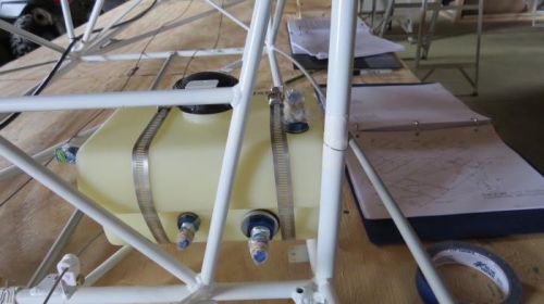

Brief Description:  Header tank
Drilled holes in header tank for fittings. Installed tank fittings using blue loctite. Leak checked and sealed all fitting to lock out contamination. Installed header tank with supplied straps. Not happy with the mounting and will devise a method of making tank more secure, including antichaffe tape under straps.
Rear of header tank
Rear of header tank
