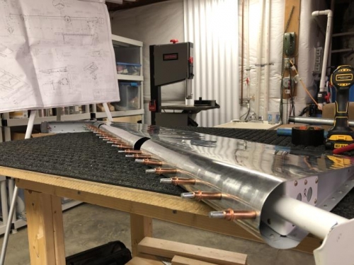

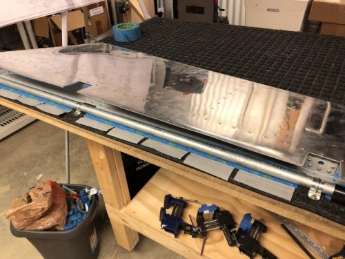

Brief Description:  Rolled leading edge of right elevator
Finally couldn't put it off any longer and rolled the rightelevator leading edge. Used a pair of pipe clamps to keep pressure down on the skin during roll to prevend a bend at the bulkhead edge. Pretty happy with the result.
