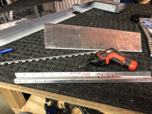

Brief Description:  prepped trim tab for assemly
Deburred all components and holes in trim tab.
Dimpled skin for rivets.
Dimpled spar with substructer dimple dies, then countersunk top row of spar.
scuffed and cleaned inside of skin and whole sparand hinge for primer.

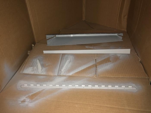

Applied primer in makeshift paint booth. Will build a proper one in new garage.
