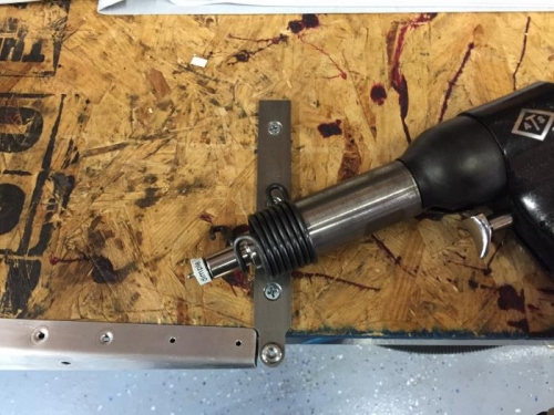

Dimpled ribs and spar with subframe 3/32 set.
Had to use tight dimple method on aft 2 holes on the ribs. Suspect I may have to use the MK319BS pull rivets on those as well. Will try regular method first, at least on the top.

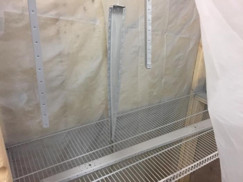

prepped all riibs and spar then primed.
Dimpling ribs and spar
dimple solution for tight spots
and primed
and primed
