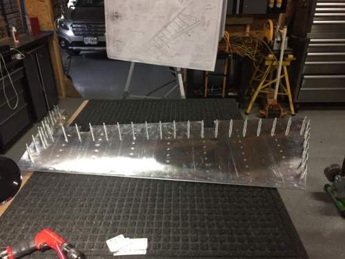

Clecoed right elevator frame together and clecoed
Clecoed E-703 , E-704 and E-713 back to E-702 spar
Clecoed and match drilled E-709 root rib to spar.
Clecoed E701 right elevator skin to fram and match drilled.

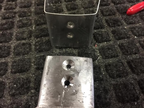

Dimpled E713 for bolts through E-714.Countersunk E-714

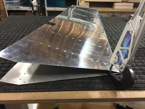

Deburred right elevator skin and dimpled.
Clecoed skin and match drilled
Dimpled and countersunk for Counterbalance weight
Right skin dimpled
