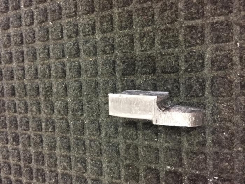

Replaced E714 and used it as a pilot to drill holes through to front of ribs E-703 and E-704
Trimmed E-714 to size by drilling a 1/2 inch hole for a radius then the band saw to square it off.
clecoed and match drilled
Drilled to #12
Counterweight trimmed
