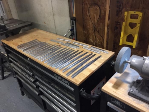

Brief Description:  Finished stiffeners and match drilled to skin
Finished making all stiffeners by smoothing cuts on scotchbrite wheel. Still need to fashion 702-J,K,L from D,E,F for left by modding per plans, but will do that when I fit the left stiffeners.

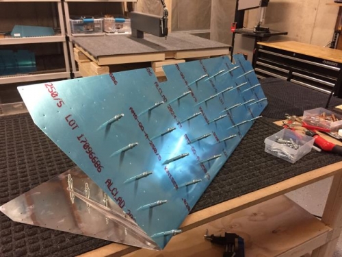

Clecoed stiffenrs to right elevator skin and match drilled
Finished stiffenrs
Finished stiffenrs
Match drilled stiffeners
