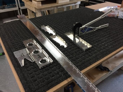

Deburred and dimpled the right HS forward spar and ribs.

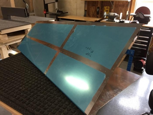

Removed enough part of plastic coating to be able to debur both HS skins

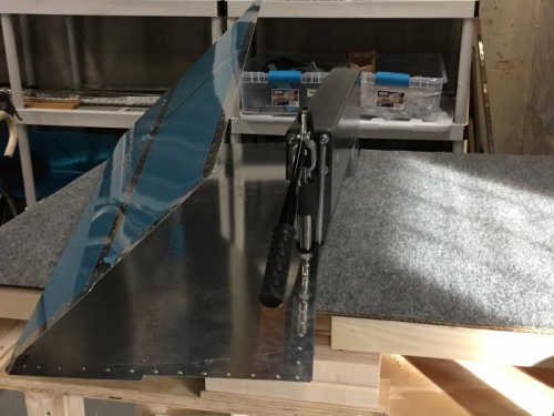

Deburred then dimpled both HS skins. Was able to use new DRDT-2 Dimpler on all but a few
holes. Very happy with the results. Mush smoother ans consistant dimples. Used the squeezer for last 2 holes at the leading edges on the sides. There was one hole in the middle near the leading edges on the center rivet line that I needed to use the tight quarters set with the pop rivet puller. Thes worked quite well for a first effort.
Deburred and dimpled Righ HS frame
removed coating on skins
Dimpled skins
Dimpled skins
