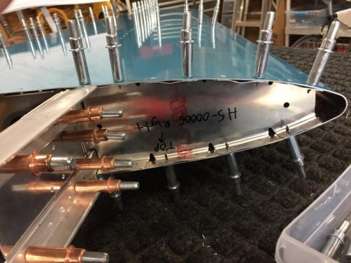

Using drawing measurements, drilled the two holes in the aft flange of HS-00006 and forward flange on HS-00005 to attach to the forward spar.

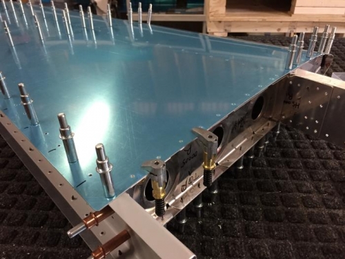

Assembled Both HS Frames and attached Both HS-801pp skins.

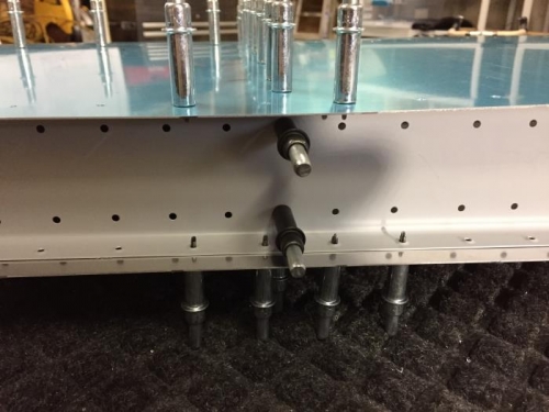

Matched up rear spar to Frame and drilled out the HS-708 flanges to #21.
Matched the HS-00005 Ribs to the rear spar and drilled through spar holes to match the flanges then clecoed.
Alligned the HS-00006 and HS-00005 ribs to the skins and useng skins as template, match drilled them..Then used skins to match drill the inboard sections of HS-702 front spar.
Used pilot holes in HS-00005 and HS-00006 to drill through the forward spar . Good edge distances acheived on all.
Match drilled all holes in the skins.
