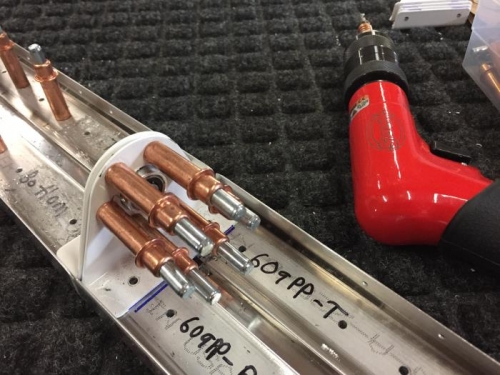

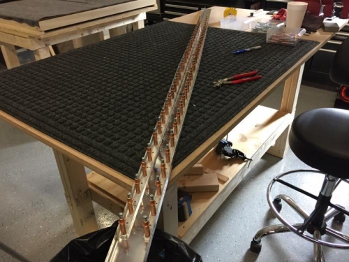

Rear Spar started
Deburred the HS-609 spar reinforcement bars and radiused the outside edges to fit into HS-603
Clecoed Both HS-609's into the HS-603's and fit HS-413 and HS412 brackets into position as well as the HS-411's with the VA-146 bearing in place.
Match drilled all the #30 holes in spar, then drilled out the HS-708 holes to #21
Match drilled the second HS-411 using the predrilled HS-411 and VA-146 as a guide.
HS-603 and HS-609 clecod
HS-412 in place
HS-411 and VA-146 match drilled
