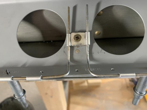

Flap hinge mod
Decide to go with the split hing 2 piece mod to enable easier removal of the flaps.
Installed a #8 nutplate .
removed two flanges fom wing side and one from the flap side to accomadate the mod.
