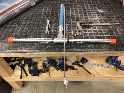

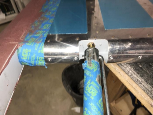

Made rod end bearing installation and measurement
Repurposed the pipe used to bend leading edges to make a rod end bearing installation tool.
drilled it to 3/16 and bent a 3/16" rod to fit.

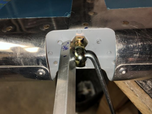

Used a piece of channel aluminum to measure the needed 13/16" distance from the bulkhead to rod end bearing center.
